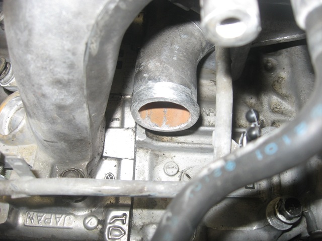

Below are some pics of the shortened water pipe, with the welded lip filed down. That was a major PITA, but the lip should help keep the coolant inlet hose from slipping off. Basically, I welded a "ring" around the water pipe, cut off the pipe on the aft side of the "ring," and then shaped the lip with a file. Probably more than needed, since this pipe is in "suction" and likely wouldn't slip off with a hose clamp... but I have access to an aluminum MIG setup, and I'll sleep better at night knowing the hose can't slip off.

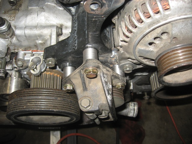

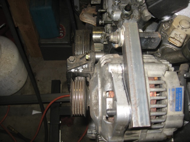

I'm also attaching a couple of pics of the final (almost) alternator setup. You can see the 0.70" spacers I spun on the lathe -- though they're still raw/unfinished -- as well as the upper mount. I still need to clean up the welds of the upper mount, trim the angle iron "connector," polish the spacers, and then paint the whole shootin' match. The belt now lines up perfectly, though I'll need to use a 3-rib belt to match the tensioner; the alternator and outer crank pulley are 4-rib.
