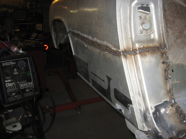

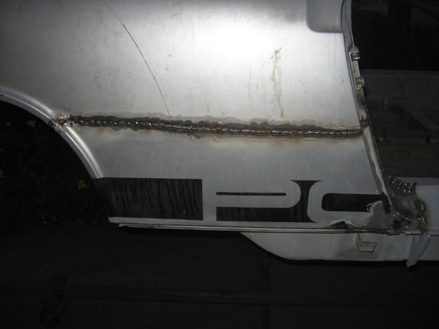

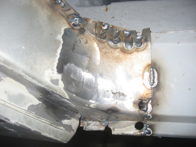

Tonite I also welded on the lower passenger side quarter panel that I had to cut off to make the hellhole repairs. The factory panel had some rust "thinning/swiss-cheesing" that required some careful repairs. First off, I sand-blasted the entire backside of the thing, as well as the frontside areas that showed rust bubbles. Then I welded in a couple of very small patches, and carefully tacked in some plugs where the metal was particular thin (read that, where light shined through!).
Here is a pic of the lower piece welded in.
The most difficult part was replacing the compound bend at the forward/lower part that connects with the sill plate (i.e., below the lower rear part of the passenger side door). But I think it came out looking pretty good. I welded that piece to the factory piece on my bench, and ground down the topside welds prior to connecting it. Below is a pic of that repaired area, prior to trimming and smoothing. As you can see, I also need to fill in a couple of spotweld cutter holes with small round patches.
Here is a pic looking back, with a shot of my trusty/cheapo Craigslist welder poking its head in. It is a Clarke EN130 110volt unit using EASYGRIND 0.023" wire and 75% argon / 25% CO2 gas...
This takes quite a while to avoid imparting too much heat -- weld a spot, blow it cold with compressed air until your bare hand feels no heat, move over 5-6" and weld another spot, and repeat a gazillion times. I still need to grind down the welds and take some pics.
