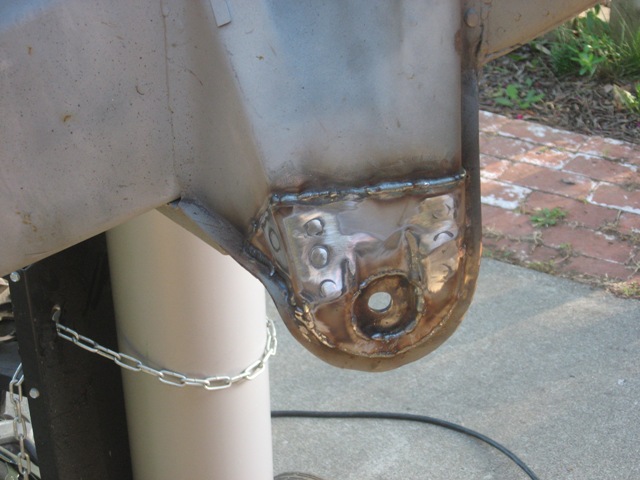

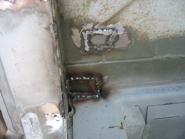

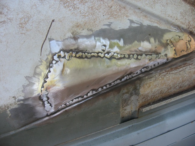

Had a chance to spend some more quality time with my project this weekend. First off, I received my pre-bent inner suspension console reinforcement kit from Tangerine Racing on Friday, so I welded it in that evening. It fit without any drama; here is a pic of the passenger side:
I also started to make some firewall repairs due to rust-through and to finally patch up the hell-hole repair.
