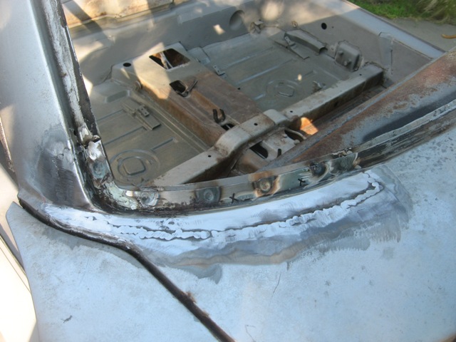

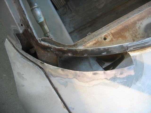

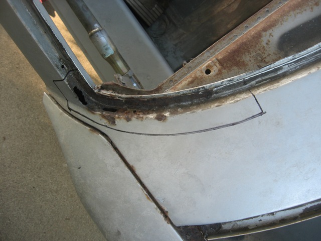

Both lower corners of my windshield are crusty. I picked up driver and passenger side fender/cowl cuts from Derrick (can't remember his 914World name) in Palo Alto. While they had some rust in them, they were in far better shape than my car's.
Here is a pic of the passenger side lower corner:

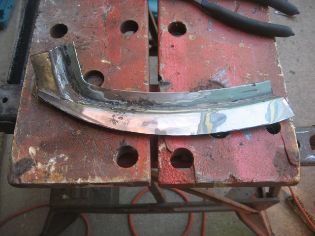

It took about 90 minutes to carefully cut out the passenger side piece I needed from the donor fender/cowl. It took every tool in my box (air body saw, jigsaw, sawzall, 1/8" cutting wheel on a die grinder, carbide burrs in a die grinder, etc.), and a ton of patience! Here is that piece prior to being fully cleaned up.
Here is the cut-out, followed by the piece rough grinded (I forgot to take a pic of the piece welded-in / pre-grind). I used my friend's spot-welder to tack up the piece along the seam, and my trusty MIG to complete the butt-welds. The lead used by the factory at the cowl/fender seam caused a lot of popping, and the lead flew when I cooled each tack weld with compressed air...
I'll tackle the driver side lower windshield later this week.
All told, I spent about 15 hours this Fri-Sun making these repairs. While the progress is seemingly slow on these little projects, I am heartened that they're done. I can't wait to begin the motor/trans mounting effort, as well as the fender flares project -- but I still have some more rust to deal with.
