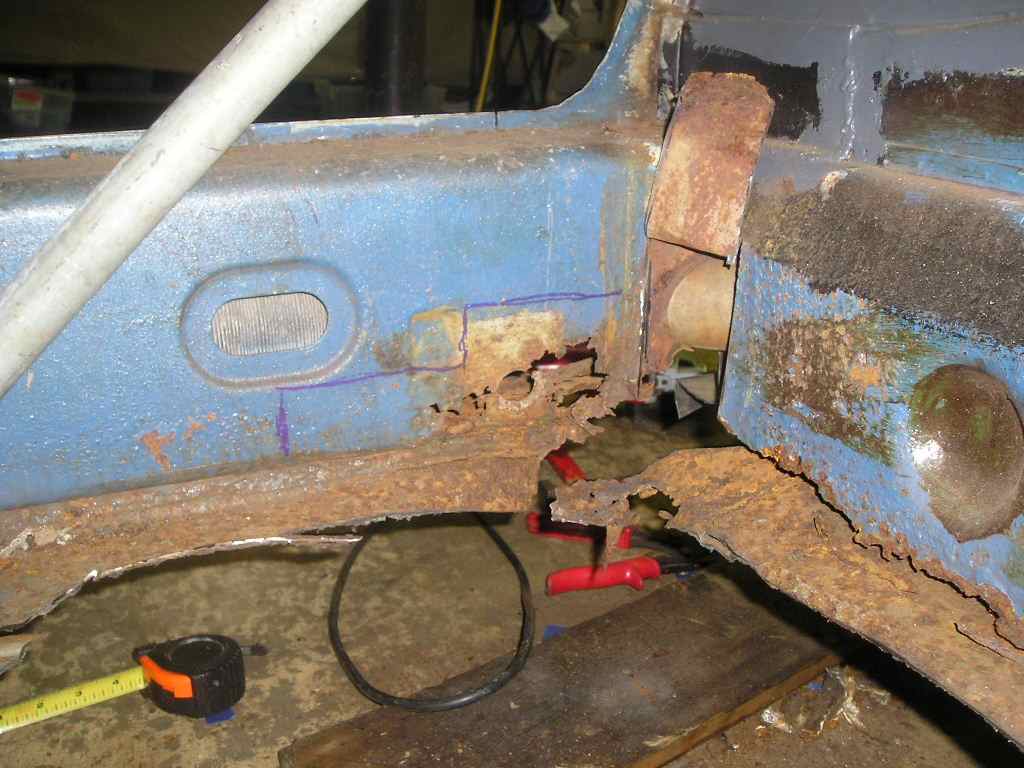

So today I got a lot done. I started off wanting to get most of the long done.
Rust=Bad
The piece I made to go in after I cut all the bad stuff out.
And then the piece welded in.
