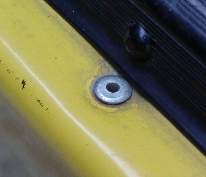

Side Valences
As careful as the previous two owners were with the car, they didn’t know what we know now about one of the 914s weak spots…the Longs. My cars’ side valences had never been removed in the 30 years of its existence and I was hesitant to look. Actually, when I inspected the car before purchase, there was every indication that this car was well-cared for in its critical areas that I could inspect, and it had lived its whole life in a dry climate, so I wasn’t too worried, but I just didn’t know. We’ve all seen the carnage to the longs on other cars created by accumulated wet dirt at the jack posts in particular. I took a calculated risk and bought the car anyway because of its overall condition.
The cars side valences have the original Sunflower Yellow paint and the original factory rivets holding them in place were exposed raw aluminum, not repainted black like on typical 914s with black side valences. Last weekend I carefully drilled them out, first with a 1/16” inch pilot drill, then a 7/32” inch drill bit to completely remove them. I soaked the three M6x1.0x12 cheesehead screws with PB Blaster, and they came out pretty easily. The screws had an internally toothed lock washer over a plain washer under each screwhead, and are yellow-cad plated.
The side valences came off easily and there were two or three fistfulls of dirt that came out of each side, but the original paint at the longs was pristine and shiney, and there was not one spec of rust anywhere. Whew, big relief. I am going to try to preserve the original paint on my side valences and just remount them, but I haven’t looked at them carefully enough yet to make that call. Interestingly, there was also a large collection of debris at the front passenger wheel well, right behind the front edge of the passenger side valence. The debris was dense and rock hard.
BTW, Why do we refer to the side valences as rocker panels? The term ‘rocker panels’ doesn’t make sense to me. Does the car rock on them, or do they conceal rockers of some kind? Maybe they are ROCK(er) panels because they take a lot of rock chips picked up from the tires? It’s a mystery to me some of the terms we use.
Here is my sidevalence investigation:
