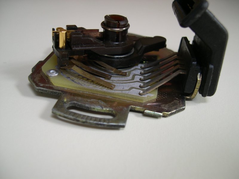

I've completed my 1.8 to 2.0 motor swap and have my car running really good, except the TPS is worn right around the partially open throttle position.
I've cleaned the surface and the contacts with 2000 grit sandpaper and then used Deoxit electrial contact cleaner. This helped as it only hesitates/bucks at the barely open throttle position and cleared up the issue at positions further along the path of travel. I imagine that it's worn right at the spot where you're most often running at.
I searched but couldn't find any threads on repairing this. What I want to do is move the circuit board to the right or left, so that the contacts run on a fresh part of the board. Any ideas on how to separate the circuit board from the metal body and how best to reattach it? It looks like it may be soldered at the bottom right corner.

Here is a pic with the connector reinstalled onto the sensor base. I found that the plastic of the connector cracked when I removed it from the base, so now, it isn't held as securely. You'll avoid this possibility if you leave the connector in place when doing the board replacement. It'll be a little more difficult to get the board into place under the connector contacts, but the business-card trick will be helpful.

davesprinkle   Circuit boards arrived. Here's a pic. Testin...   Jun 22 2009, 08:49 AM
davesprinkle   More pics of initial board installation in this th...   Jun 22 2009, 03:37 PM

McMark   <_< Posting pictures here is apparently dif...   Jun 23 2009, 01:00 AM
davesprinkle   <_< Posting pictures here is apparently di...   Jun 23 2009, 09:50 AM
kwales   Yeah, that's a really good picture on the othe...   Jun 23 2009, 09:46 AM
davesprinkle   A business card makes a good ramp for getting the ...   Jun 23 2009, 09:51 AM
davesprinkle   Here's a pic of the board with the business ca...   Jun 23 2009, 09:51 AM
davesprinkle   Rivet installed. I would urge you to fend off the...   Jun 23 2009, 09:54 AM
davesprinkle   Here is a pic with the connector reinstalled onto ...   Jun 23 2009, 09:56 AM

davesprinkle   Question: Is the conductive material on the board...   Jun 23 2009, 06:45 PM

davesprinkle   Jeff Bowlsby installed the board on his 2.0liter. ...   Jul 6 2009, 09:29 PM

davesprinkle   OK everybody, sorry for the delay. I've compl...   Aug 24 2009, 10:53 PM
