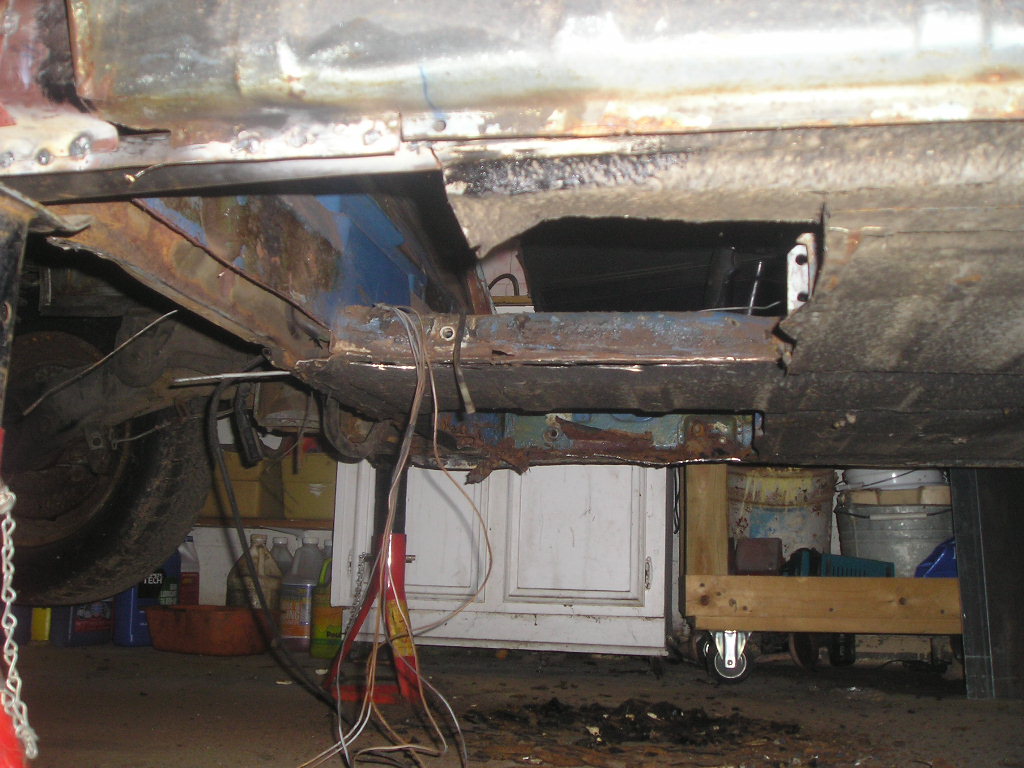

Well I have been pretty busy the past week or two so only a little progress has been made. The suspension mount I had was beyond worth repairing so I am waiting for that part to arrive. Meanwhile I started working on the floor area.
I cut most of the old floor out
I also removed all the floor tar and found some more areas of rust.
Here is a spot I will need to repair
