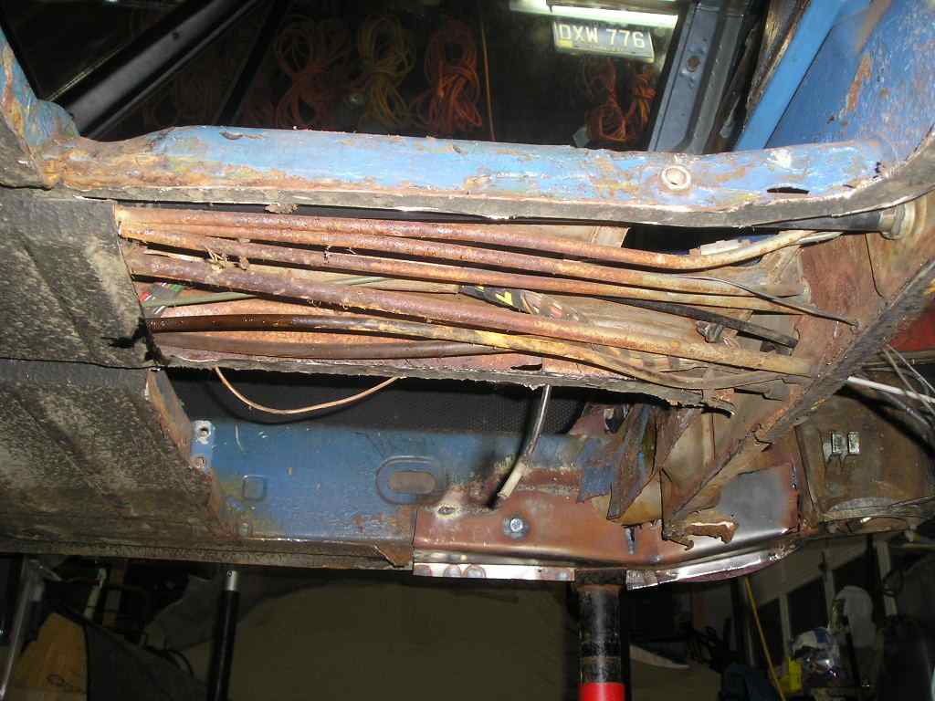

Well I was trimming for the floor and I found some more rust in the driver's side long. I wasn't sure how bad the rust was and now I know. I will have to replace this area as well before the floor goes in. Luckily I have a four day weekend coming up so I will have plenty of time to work on the car!
Here is the new floor held up in place
The center tunnel lines are luckily all solid. The clutch tube broke at some point and the PO did some handy work which I will correct before the new floor goes in.
