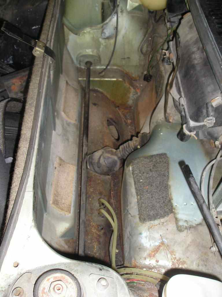

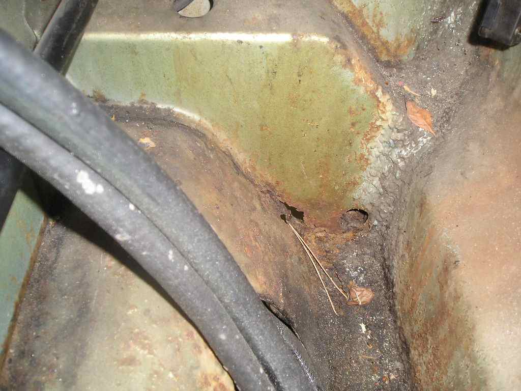

I took the gas tank out tonight. The rust that was in the passenger foot area extends under the gas tank and into the front wheel-well. The gas tank was also repaired on the bottom at some point and you can hear some rust rattling on the inside. I will most likely just replace it with another tank I have lying around.
