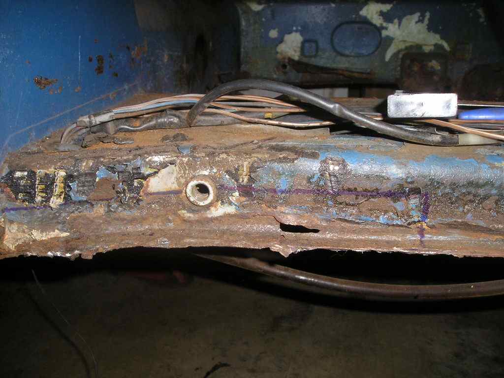

I did a little more tonight. I got tired of cutting more and more out of the car so I repaired a piece on the tunnel.

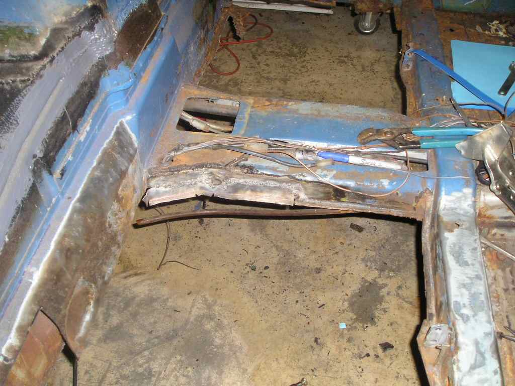

I also cut some more rust out in the passenger corner

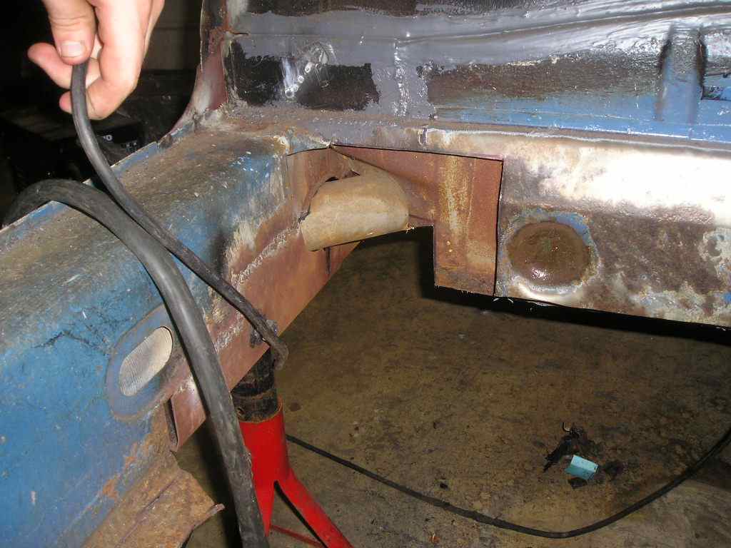

And I also cut the seat mounts from the old floor pan and got them ready to use.
