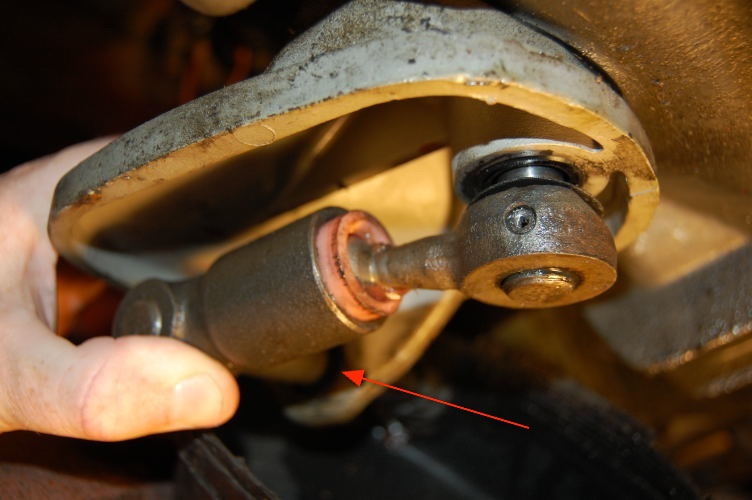

I have been trying to figure out why I can not shift into any gear. I checked to see if the Clutch Tube was broken and it seems fine. I also looked at the bushing at the fire wall and they seem fine. My next check was at the shift rod head. It seems that the bushing here has a lot of play, is this normal??
Here are a few pics, thanks in advance for the help.

It's a little hard to see, but it looks like you're missing this bushing.
