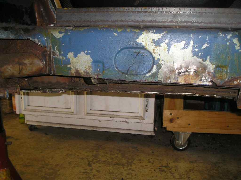

Well I made some big progress this weekend. I first repaired the driver's side long

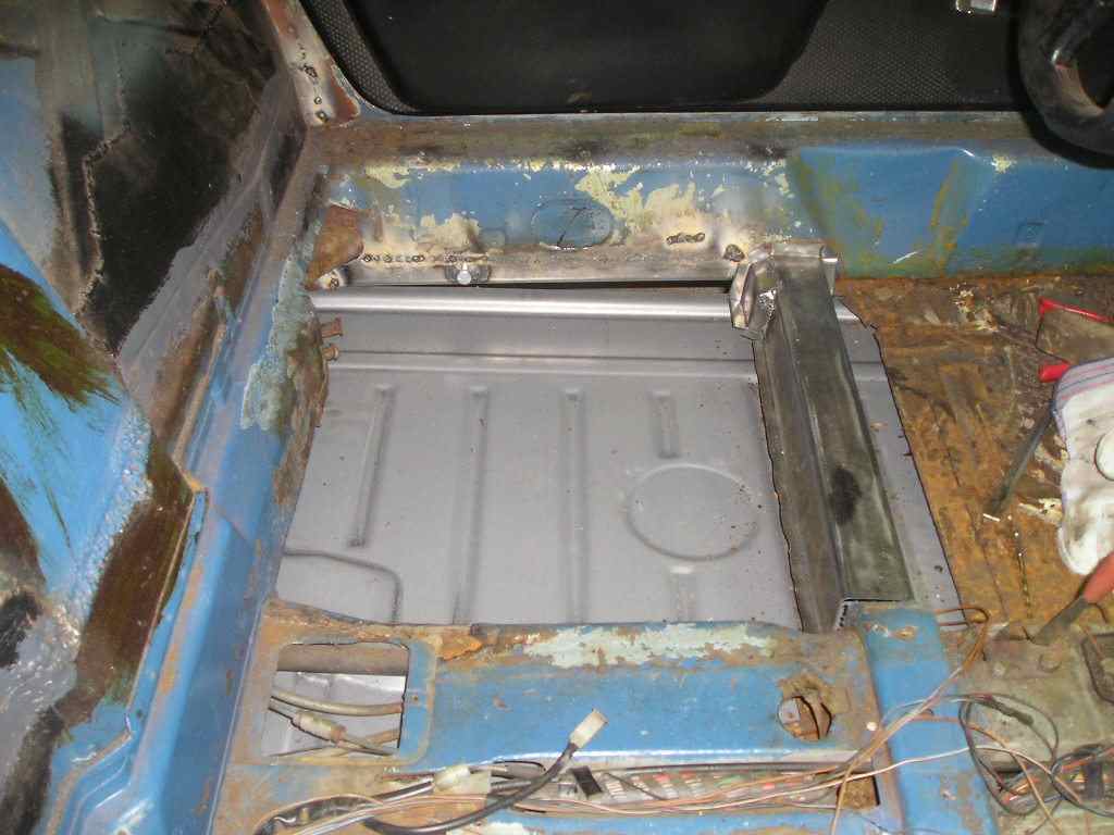

I then fabricated a crossmember for the driver's side
And I added a piece for the e-brake switch
sitting in place
And last but not least... I got the floor put in! (IMG:style_emoticons/default/piratenanner.gif) It is just tacked in place but I have to say I was pleased at how nicely it went in and how everything lined up. I had to do a lot of little things before putting it in like cleaning all the mating surfaces and fixing the clutch tube so that took some time.
This week I will work on finishing the firewall, rust spots around the center tunnel, adding the crossmember and the seat hinges. I am also waiting on some parts to get here so more progress to come. Enjoy!
