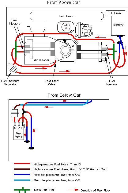

Maybe this informaiton previously posted by Andy will help:
"S" is suction (from the tank), "D" is Druck or pressure to the FI system and "R" is return (pump bypass if a clog occurs in the engine lines) and is "T"ed to the line from the pressure regulator and then back to the tank. EDIT: Here's Dave Darlings diagram: ![]() |

Dave_Darling My bet is that you got the hoses on the wrong fitt... Jul 7 2009, 08:43 PM

My bet is that you got the hoses on the wrong fit... Jul 8 2009, 07:41 AM
Dave_Darling No markings? Yikes, that sucks!
The R port i... Jul 8 2009, 08:34 AM
Cap'n Krusty I think you're on the right track, Dave. The ... Jul 8 2009, 09:21 AM
AvalonFal OK, here's the result.
Apparently the 3 port... Jul 8 2009, 10:34 AM
