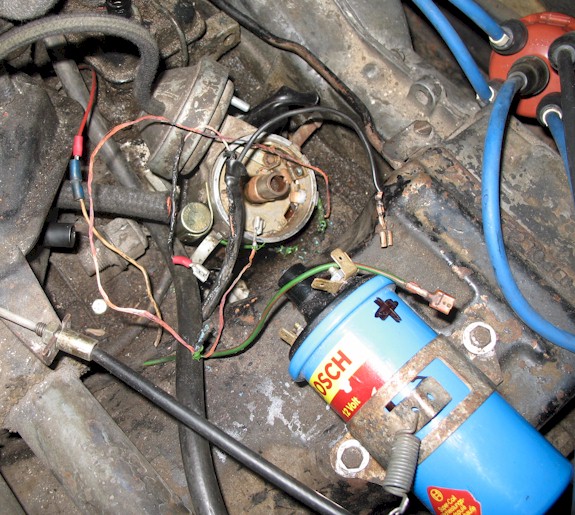

why did my wire from my coil to my points/condensor fry - up in smoke : (

i could have sworn that i did not move this wire from one side of the coil to the other - is it possible the car could have run with this wire on the positive side of the coil? cause it was running but i was having trouble with getting fuel pump to operate.
i just ordered some crimps and a good crimp tool - to fix this issue.
also - is the right side of the coil label always the hot side - without pulling it out of the car - i can't see + -
edit - i just pulled it and marked it with a sharpee.
so condenser wire (now fried ) goes to neg side of coil.
i have on remaining fried wire - you think it is my tach wire? thsi goes to neg or pos
what is the remaining good black wire? this goes to neg or pos?
my oil pressure switch is busted - that is my green/red wire - correct?
jim

jt914-6   The condensor wire should be connected to the nega...   Jul 6 2009, 05:17 PM

jt914-6   The condenser wire and the tach wire (blackW/purpl...   Jul 7 2009, 04:05 PM
