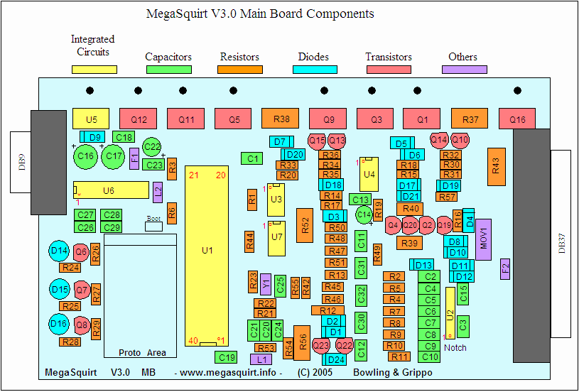

I found this. In case anyone else is looking and comes across this thread and needs to know where the Q19 transistor is physically located on the board.

mightyohm   The fuel pump driver transistor is Q2, it should b...   Jul 9 2009, 02:56 PM
RJMII   Thank you for the diagram. other than the fuel p...   Jul 9 2009, 03:05 PM
