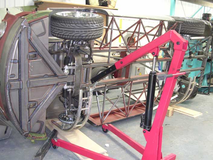

Any updates John?
Here's an idea to update your Rocking Chair (Termites can be bad)
