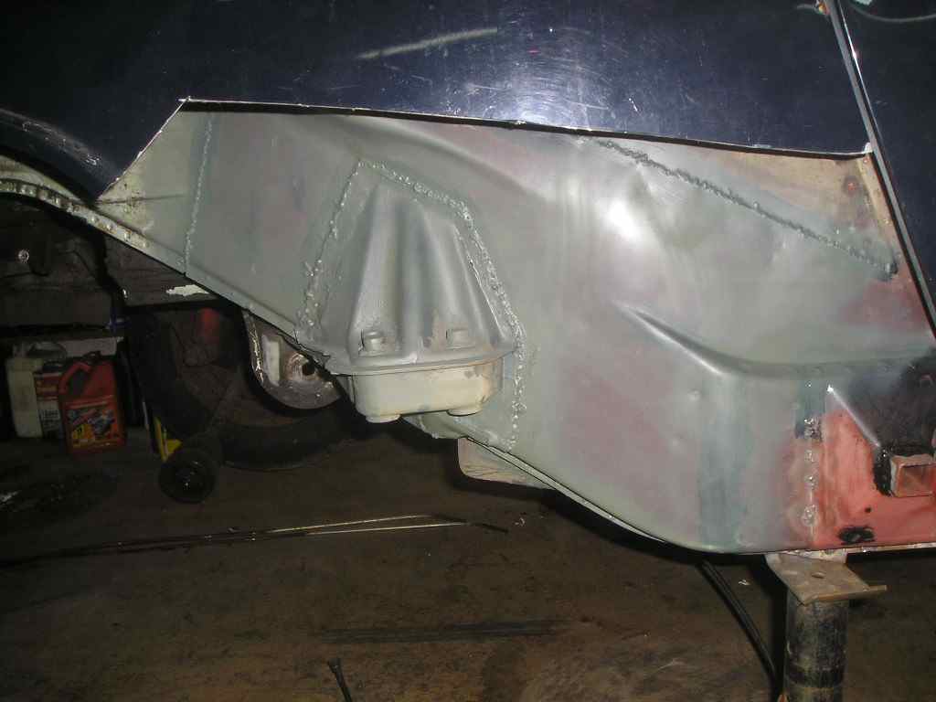

I got some more work done. (IMG:style_emoticons/default/biggrin.gif) I received a box today with the suspension console, e-brake mount and cover in it. I went ahead and cleaned up the suspension mount and welded that on. (IMG:style_emoticons/default/welder.gif) Finally my car is able to roll again!
A lot of stuff on the to-do list is just welding and cleanup. I have to finish welding in the floor, crossmember, firewall, e-brake stuff, and both rear fenders not to mention the small rust in the passenger footwell and the front weather strip channel that needs to be repaired. I have also been trying to find a local powder coating place for all the engine tins so hopefully I will have something lined up within the next week. So much to do and so little time.
