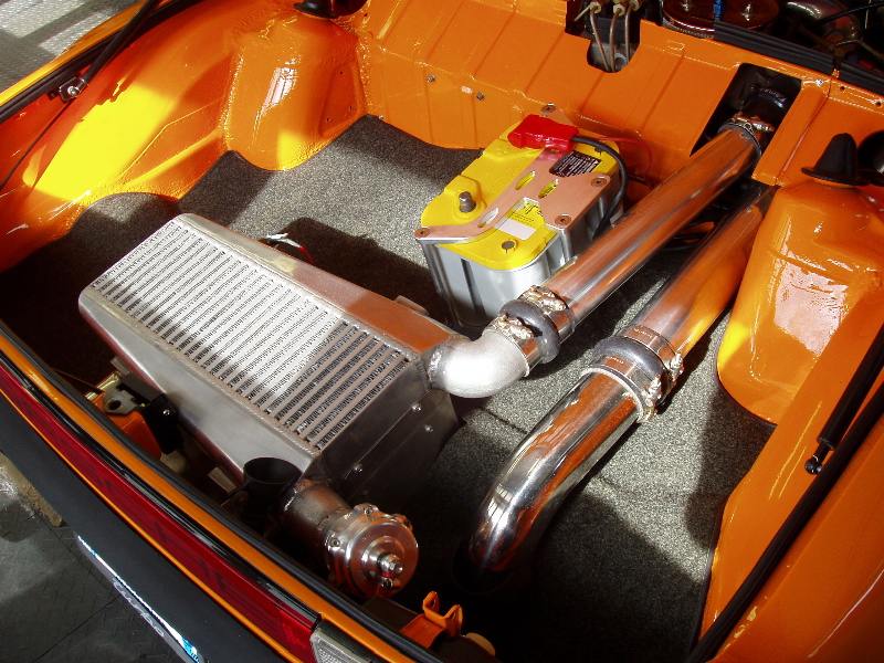

First matter of attention is the intercooler placement. I have a small water to air intercooler tucked in front of the pulley on my subaru motor. It works great, but i am getting a little too much heat soak on the aluminum tubes leading to it. I was debating an idea of putting it in the rear trunk or in the fender since placement wouldnt be a factor because its a water to air. I do like the one members ORANGE nice turbo car on 914world here with the air/air one in the back and vent in the wing.....

Marty, Clewett and I all put ours back in the trunk, why not air to air, get it out of the engine compartment and give it some fresh unheated air....

iamchappy   As you mentioned, i put mine in the trunk using 2 ...   Jul 30 2009, 10:58 AM

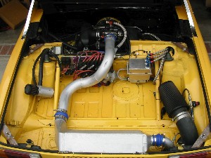

d914   something like this might work ,, mounted low in t...   Aug 4 2009, 09:07 PM
moparrob   something like this might work ,, mounted low in ...   May 19 2010, 08:57 PM
