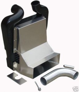

As all you probably know, i have a ej20 turbo subaru in my car. I love it and it runs great, but now i am at the point where i want to streamline how well the system works.......
First matter of attention is the intercooler placement. I have a small water to air intercooler tucked in front of the pulley on my subaru motor. It works great, but i am getting a little too much heat soak on the aluminum tubes leading to it. I was debating an idea of putting it in the rear trunk or in the fender since placement wouldnt be a factor because its a water to air. I do like the one members ORANGE nice turbo car on 914world here with the air/air one in the back and vent in the wing.....
Looking for ideas....

something like this might work ,, mounted low in the engine department
