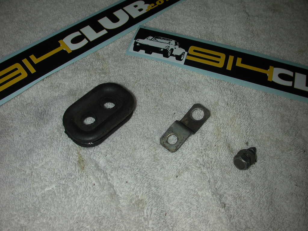

So I have the shroud and it's bits (the two "other" pieces") tacked in to place. But I have a couple of parts that I have no recollection of where they go, and in scoping around, couldn't see any possiblities. I normally group parts and bag them -- but this time I did not label them (shame on me) so I have a pic of three parts that I just don't know where they belong. And I don't wanna tighten things down without knowing they don't somehow go "underneath".
Here's the pic. Any help appreciated as always!

ArtechnikA   the sheet metal capscrew i can't help you with...   Feb 9 2004, 08:48 PM
krk   Rich, Thx muchly. That makes perfect sense. (the ...   Feb 9 2004, 08:53 PM
Gint   Rich is absolutely correct on all counts.   Feb 9 2004, 10:09 PM
krk   Ok, putting in screws from the sides are clearly t...   Feb 9 2004, 10:54 PM

krk   So I took a couple of hours of this afternoon -- w...   Feb 10 2004, 06:29 PM
krk
  Feb 10 2004, 07:12 PM
Gint   You got it. It's a ground wire.   Feb 10 2004, 08:53 PM
