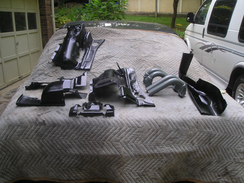

Here are some of the tin after they were painted.

dlee6204   Wow so its been a while since I have last updated ...   Aug 10 2009, 09:38 PM
dlee6204   And here is what the engine looks like now. As yo...   Aug 10 2009, 09:45 PM
dlee6204   One more of the engine.   Aug 10 2009, 09:47 PM
