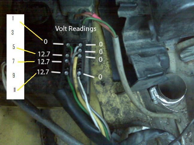

Was your plug messed with?
Your coil is correctly wired in.
In the pic here is what is supposed to be:
1 - Oil pressure switch, correct @0v
3- Blank, correct
5- Tach wire from (-) terminal on coil, black and purple, should not read 12.7v.
7- B+ to (+) side of coil, key on power, black and red
9- Blank, correct
11- Heater blower power, taken from the fuse on the board that also powers the fuel pump and AAR. You should only get volts here when the heater blower is switched on.

tabs914   Here are the volt readings with the ignition on. B...   Aug 15 2009, 10:25 AM
Dr Evil   Was your plug messed with? Your coil is correctly ...   Aug 15 2009, 11:33 AM
tabs914   So the green heater wire shouldn't be plugged ...   Aug 15 2009, 11:42 AM
Dr Evil   Ya, that would explain the power on the pin. That ...   Aug 15 2009, 12:00 PM
tabs914   Ya, that would explain the power on the pin. That...   Aug 15 2009, 12:05 PM
