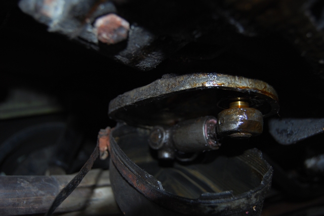

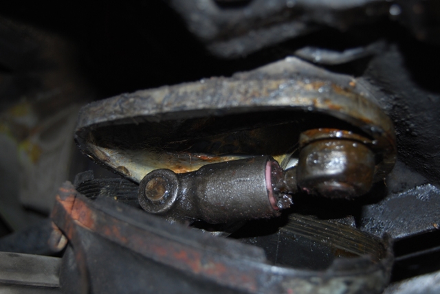

So I took everyones comments and checked it out. It appears that the shift console on the tranmission is not moving up far enough to hit first. If you look at the 1st pic, this is when the shifter is in the first positon a lot farther than normal and the car is missing first. The second pic I helped the console move up and engaged first.
My questions is: does the shift rod move the rod up on the transmission or is this part of the transmission. I guess i need to know if the transmission is the issue or alignment. Dr. Evil (tranmission god) took a stab before I took the pics and suggested it may be the engine/trans mounts. Any more suggestions before I dive in and figure this out would help. Beyond mounts, is there a procedure for adjusting this??
