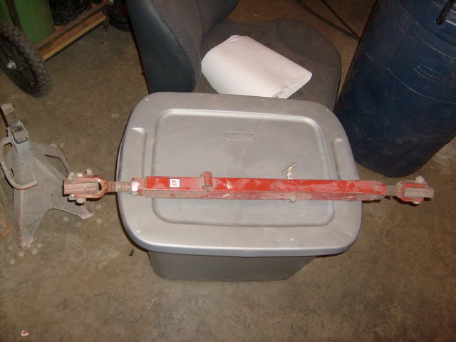

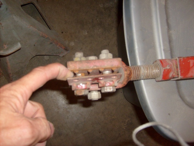

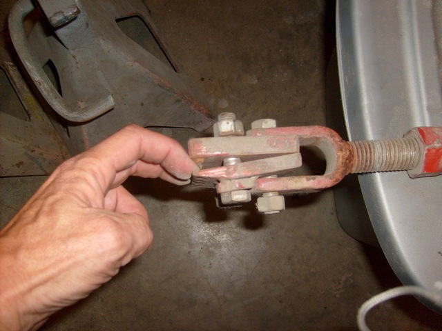

Here you go. It's hard to see but the jaws have teeth that bit into the pinch weld flange.The threaded section is right and left hand thread so when you rotate the square tube it extends or retracts.
If you want I can put it in a card board tube and ship it to you. It's kind of heavy and shipping could be expensive.

rick 918-S   Here you go. It's hard to see but the jaws hav...   Aug 26 2009, 11:58 PM
jmill   Thanks for the pictures. No need to ship it. I...   Aug 27 2009, 08:02 AM
