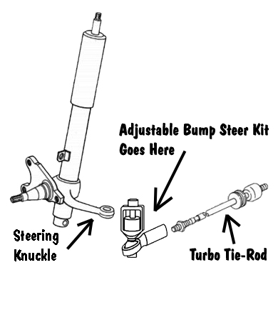

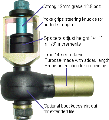

Elephant racing makes the tie rod end solution. Like everything they sell , it is high quality, and pricy: $335

QUOTE(gopack @ Aug 27 2009, 10:57 AM) *
We've been using a similar setup on the green 911 race car for years without any trouble.
Those work great and are easy to adjust.
(IMG:style_emoticons/default/shades.gif) Andy
