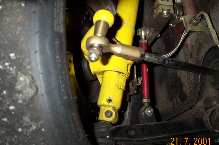

Is the test for bump steer driving over a speed bump straight on or at an angle. I don't get any noticable pulling when taking the speed bump straight on. Just want to get the test situation straight, any input will be appreciated.
Car is lowered about 50%

Angles..we gots em and it works. I'm at 4-3/4 inches at the doughnuts. I was lower but had wheel to A arm interference at a lot of steering lock & suspension compression..so back up we went.....who'da thunk it.....
Jim:
With raised spindles it takes either bending the steering arm.....which buggers up the Ackerman or tie rod extensions....these are by ERP. It can run into money to get both.

r_towle   Jim, Take a pic of your car, on the ground. Lay do...   Aug 26 2009, 09:10 PM
jim_hoyland   Jim, Take a pic of your car, on the ground. Lay d...   Aug 26 2009, 09:13 PM
orange914   Post that so we can see the whole a-arm. RIch l...   Aug 26 2009, 09:20 PM

jim_hoyland   Pics:   Aug 26 2009, 09:27 PM
r_towle   your fine. I will never suggest to anyone to put ...   Aug 26 2009, 09:38 PM
jim_hoyland   your fine. I will never suggest to anyone to put...   Aug 26 2009, 09:40 PM

turboman808   Wouldn't you idealy like the tie rod to be par...   Aug 26 2009, 10:13 PM
orange914   i really don't have real world experiance with...   Aug 26 2009, 10:17 PM
orange914   looking at the picture and reading rich's comm...   Aug 26 2009, 10:35 PM
r_towle   looking at the picture and reading rich's com...   Aug 26 2009, 10:39 PM
SirAndy   Tie rods always need to be at an angle :confused...   Aug 26 2009, 10:47 PM
orange914   Tie rods always need to be at an angle :confuse...   Aug 26 2009, 11:14 PM
