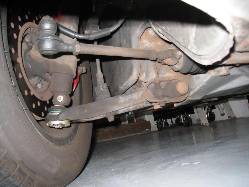

Is the test for bump steer driving over a speed bump straight on or at an angle. I don't get any noticable pulling when taking the speed bump straight on. Just want to get the test situation straight, any input will be appreciated.
Car is lowered about 50%

QUOTE(turboman808 @ Aug 28 2009, 09:46 AM) *
Wrote this long thing and then just made a diagram real quick. I need to install the 3d software already.
(IMG:http://i147.photobucket.com/albums/r283/turboman808/suspensiongeomertycopy.jpg)
Great Info here ! Thanks. Based on the diagram and discussion, I would say my suspension looks more stock than lowered...gotta use the floor as a guide, camera is at a slight angle.
Thanks to everyone who chimed in, learned a lot.
