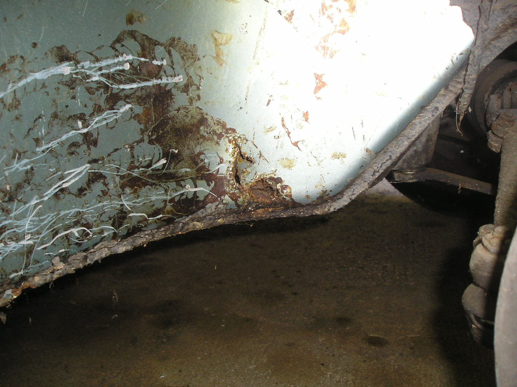

Rust in the wheel well

dlee6204   Here are some more pictures of the rust in the whe...   Sep 5 2009, 11:59 AM
