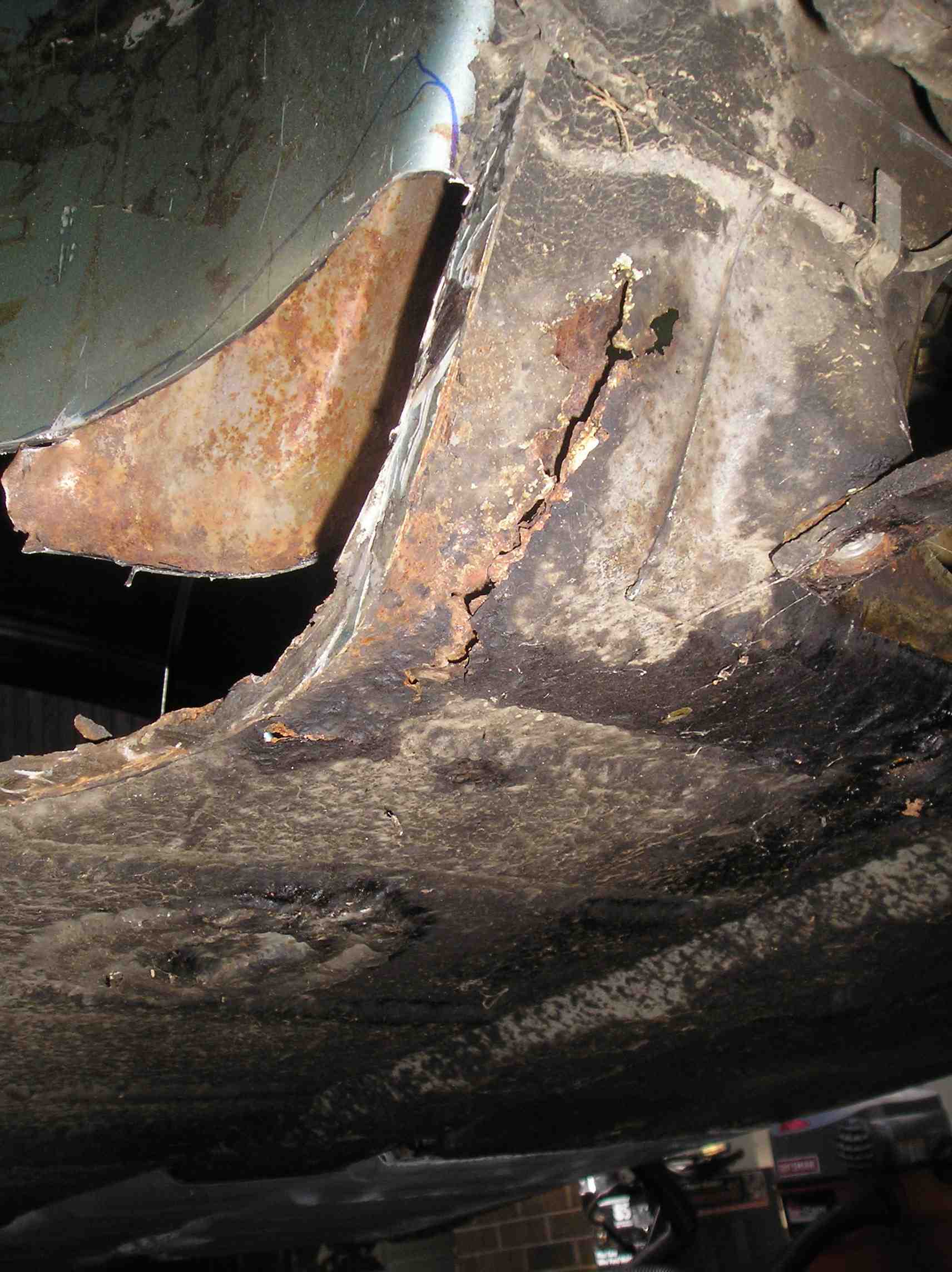

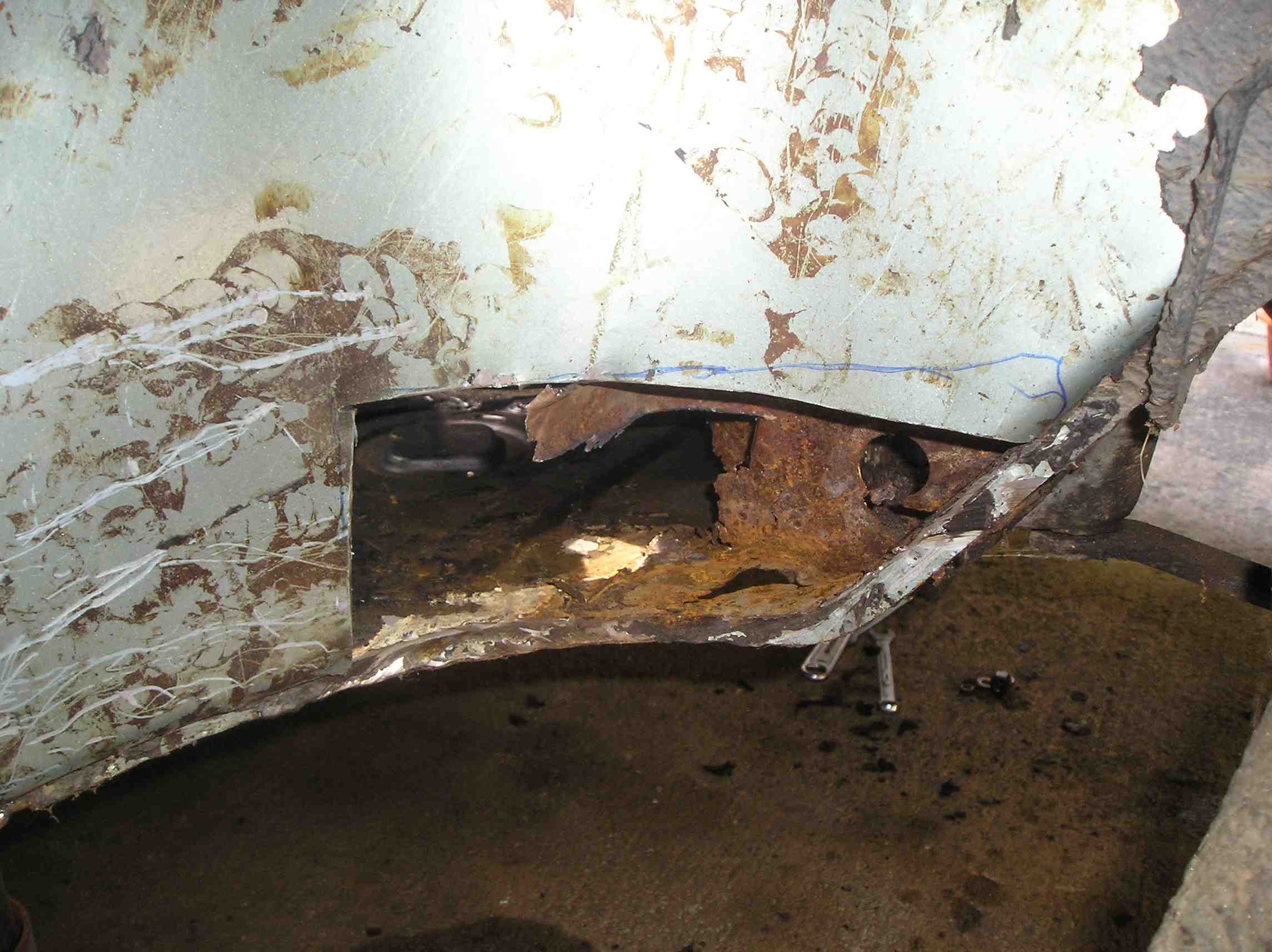

Here are some more pictures of the rust in the wheel well area

dlee6204   Here are some more pictures of the rust in the whe...   Sep 5 2009, 11:59 AM
dlee6204   From the inside... I also welded a new hinge fo...   Sep 5 2009, 12:05 PM
