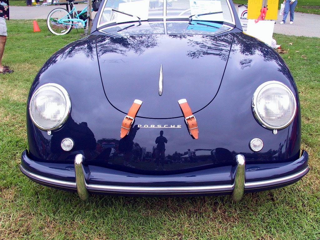

attached pic for your enjoyment- nothing to to with topic
