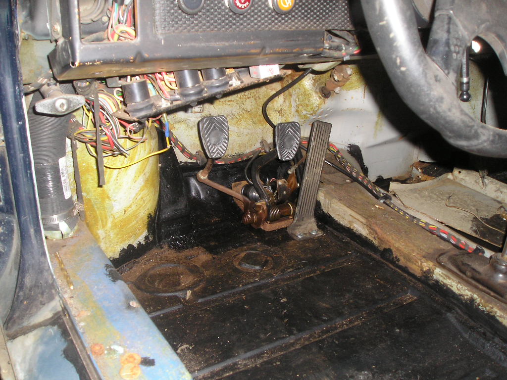

Well I got a lot of work done over the long weekend. I installed the pedal cluster and installed new accelerator, clutch, and speedometer cables, a 19mm master cylinder, SS brake lines, and new Weltmeister springs in the rear.
I also coated the driver's side floor pan.
