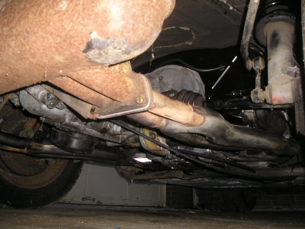

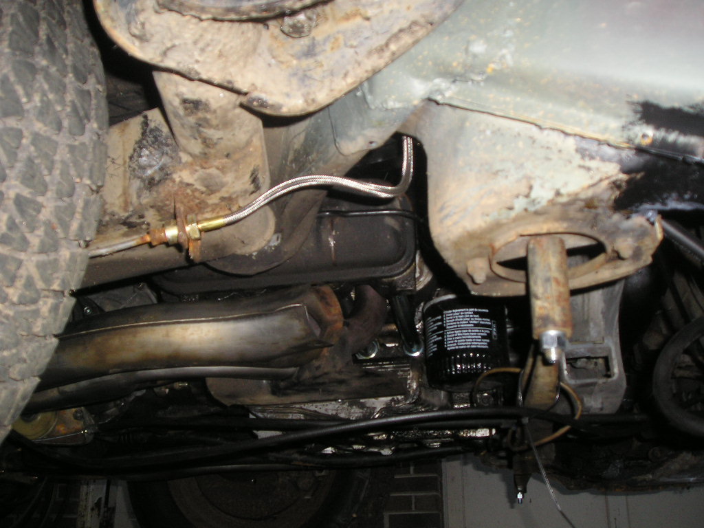

dlee6204   So I put the 914 on jack stands this weekend to ge...   Dec 13 2009, 10:24 PM
dlee6204   Hopefully you guys don't think thats ALL I did...   Dec 13 2009, 10:29 PM
