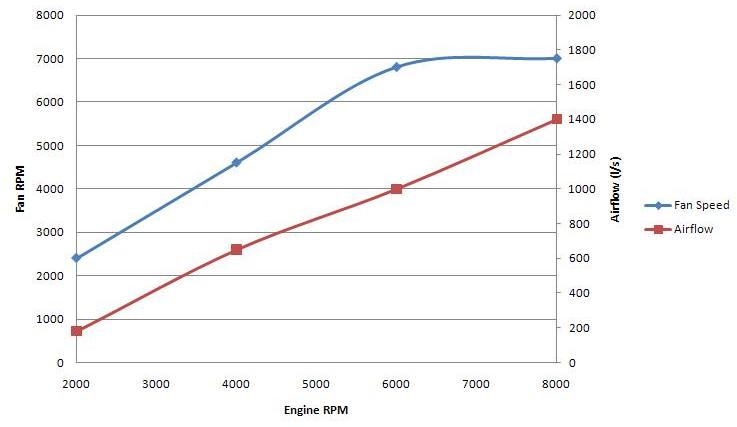

Attached ImageDownward airflow, and its equally channeled ducting, is key to providing all 6 (or 4) barrels equally supplied with large doses of cooling air . The vertical fan does a decent job, but the last 2 rear (L and R) cylinders are slightly robbed of airflow. In a 12 or 24 hour endurance race this could spell a DNF, henceforth the horizontal cooling delivery. It delivers LOTS of equally directed airflow, but at the cost of parasitic HP loss due to its being driven by the crank. The n/a or later turbo'd flat fan engines made no fuss about the hp loss--the Porsche aircooled victories (for decades) speak for themselves. Here's some data from Olaf Lang @ Porsche customer service.

The engine RPM and fan RPM don't match linearly. (IMG:style_emoticons/default/confused24.gif)
I hope they don't have that much slip.
Odd. I charted the first 3 values as a straight line but the last one would seem to indicate some slip.
Kinda interesting...Fan speed falls off, but airflow doesn't.
