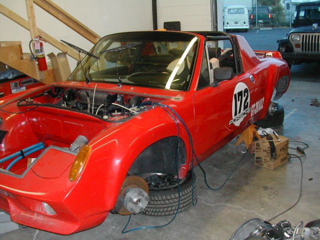

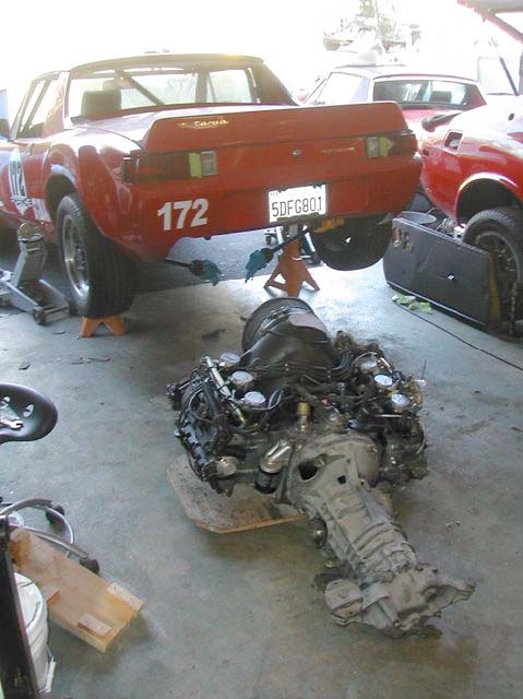

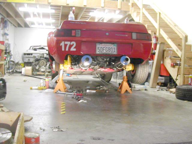

I put the car in gear, add the jack plate to the stock jack hole and up she goes. As long as the floor jack is on 3 wheels, you'll be fine.
Put jackstands under the front and back, go to the other side, repeat.
If you need extra height, turn the jacking plate sideways (as seen in the 3rd pic). I always throw the wheels under there too, just in case ...
