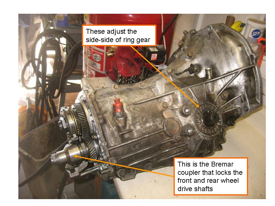

Okay, so I just got another cocktail, and thought I'd take the time to add some more details of the trans teardown.
First up is a pic of the trans on my workbench, with the rear and mid case removed. As noted, you can see the Bremar coupler. You can also see one of the two trans side covers that provide the side-side adjustment of the differential/ring gear to get a good pinion / ring gear pattern.
