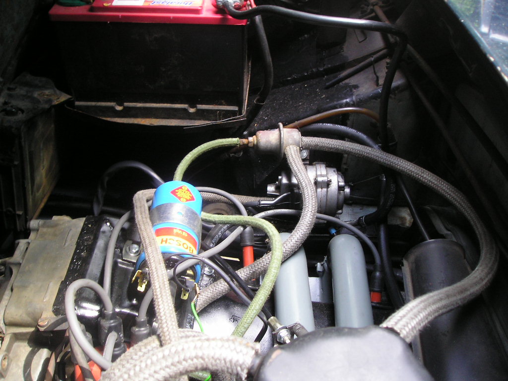

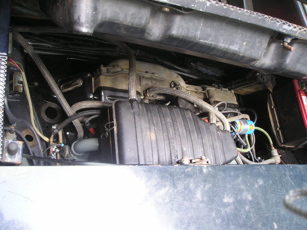

I finished up the engine and with the gas tank installed, it meant time for a test run. It started on the first crank however it ran like crap. It revved way up and it wouldn't hold idle. There must have also been a mouse colony in the muffler at some point because when I first started it up, all sorts of crap was shooting out that back. After fiddling with the motor a bit more, I learned that it helps to connect the Cylinder head temperature sensor beforehand (IMG:style_emoticons/default/blink.gif) After it was connected, the car ran very well. The only problem I noticed was that the passenger side valve cover was leaking oil. I replaced the gasket and all is well now. (IMG:style_emoticons/default/smilie_pokal.gif) I will try to get a video of it running sometime.
Here are a few shots of the engine.
