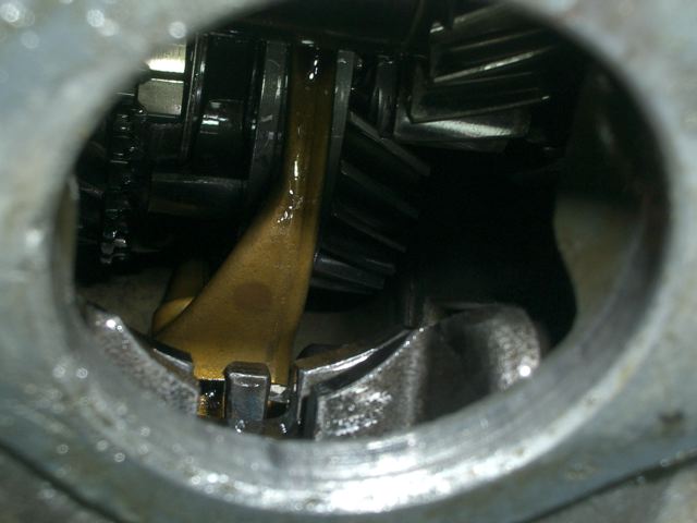

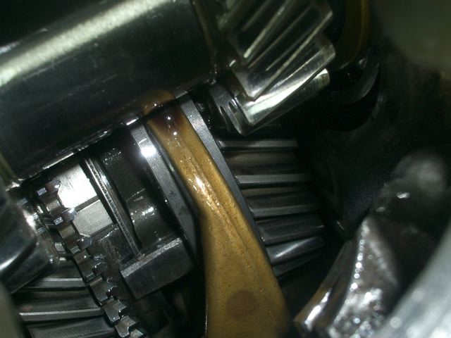

post Sep 16 2009, 12:49 AM
Posts: 69
Joined: 26-January 09
From: Los Angeles, CA
Member No.: 9,979
a few photos looking inside after removing shift console... tough to photograph. does any of this mean anything? I suspect I'll just take them up on their offer for replacement.
