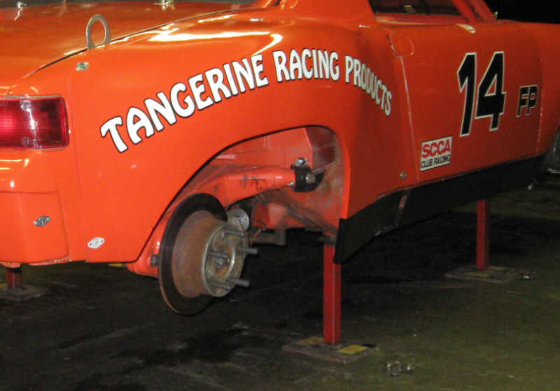

I'd love to see pictures of a 914 with the trailing arm pivot raised!
Two different 914s with the trailing arm pivot raised 3".
The white car sits higher off the ground and has -0.75* trailing arms.
The tangerine car has 0.0* trailing arms. Both have about -0.7* camber at rest.
