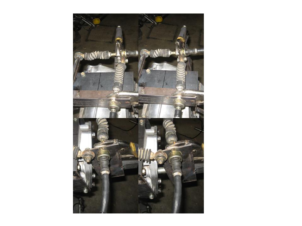

Now that the transmission is ready to go, I started on the mock up of the shifter and cables. I am using an AW11 model Toyota MR2 ('85 to '89) shifter that I picked up at a local Pick-n-Pull for ~$25, including the shifter cables. Here is a pic of the shifter on a module that I welded up and bolted to the top of the transmission.
Next up are a couple of pics of the business end of the shifting mechanism. Obviously this is a mickey-mouse mock-up -- but I wanted to see how tall the shifter upright needed to be, and where to locate the left-right stand-off. I clamped the upright to the shift-rod connector using Vise-Grips until I got the height of the upright correct, then tack-welded it. It shifts great, despite the extreme angle of the fore-aft cable. Custom cables will take out the these kinks...
It should be noted that the movement of the shift rod fore-aft and side-side is very acute. Below is a series of four pictures that depicts the side-side (note the rubber boot is scrunched when you compare the top two pics when moving the shifter from the 1-2 gate to the 5-R gate) and fore-aft (note the differing distances of the upright in comparison to the rear of the trans when the shifter is moved from 1st to 2nd).
I'll make the whole mechanism much more pretty, and weld the stand-off to the trans-to-body mount. I'll probably have to make up a new module for the shifter, too so that I can accommodate the length of the cables, which will use rod ends at each end. Stay tuned!
