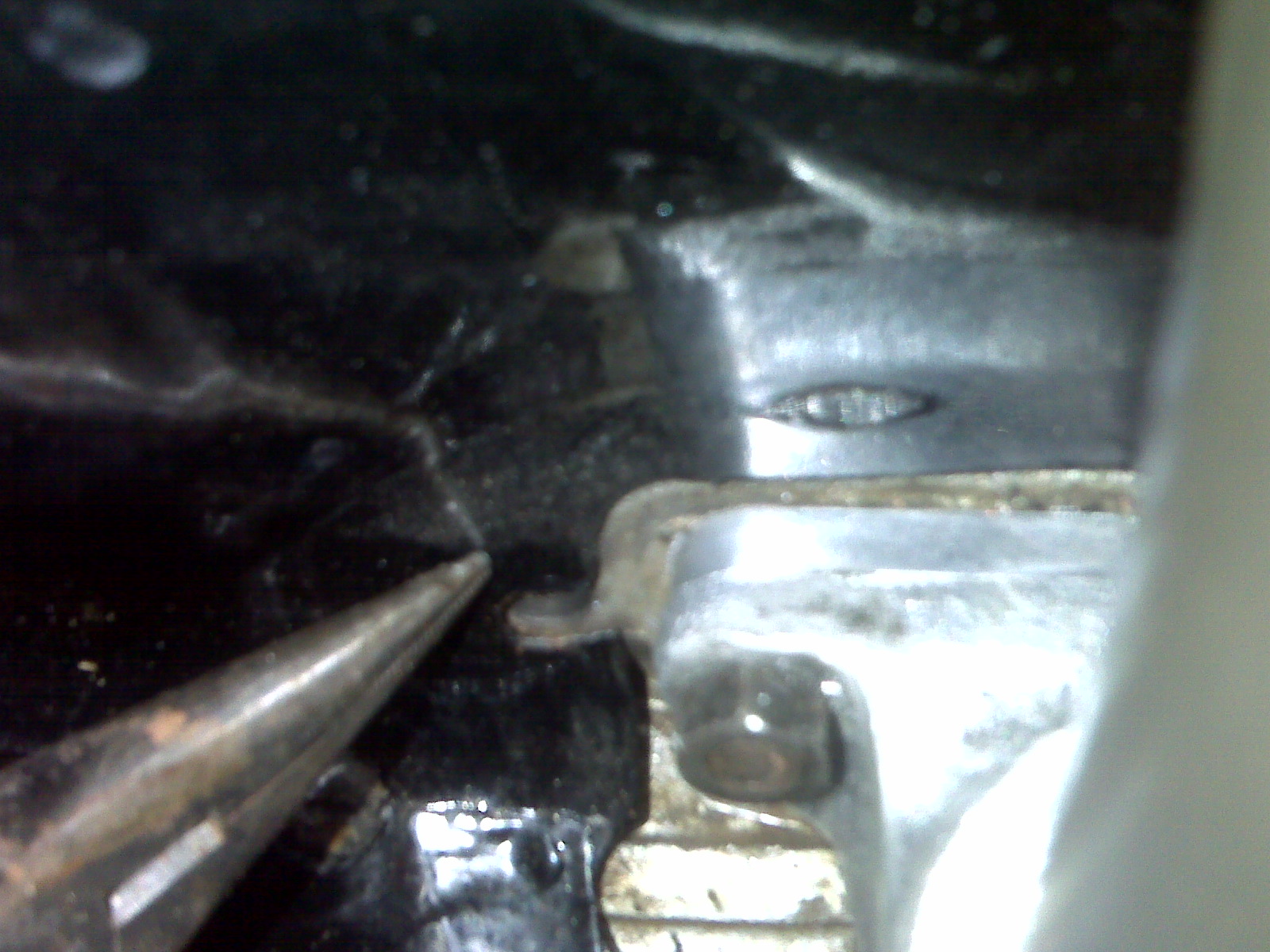

***Update*** Ditched the old motor. Oil leaks, rust and water issues. So I purchased another motor transfered all the FI from the old and slapped her in there and got her to start. Now I have a new issue... whats new right. Doing a bit of research I have what I think is a type 2 motor or bus engine. I figured out most of the odd diffs but this one. Next to each of the intakes on the head is a small 1/4" or so hole for something? It runs, but very loud. Do any of you know what I can do to plug these or put what ever is supposed to be there? In the pic I have a pair of pliers pointing to it. There are x4 of these one next to each intake.
Thanks...

Cupomeat   It is hard to tell, but the small threaded holes, ...   Sep 28 2009, 01:28 PM
tabs914   It's off a BMW I don't have the cone on th...   Sep 28 2009, 01:36 PM
Cupomeat   Ah, this makes sense now. These are the Air Injec...   Sep 28 2009, 01:56 PM
tabs914   Ah, this makes sense now. These are the Air Inje...   Sep 28 2009, 01:59 PM
SLITS   Whatever engine you have is a '75-'76. I ...   Sep 28 2009, 02:04 PM
tabs914   Hey if some one knows the length thread and diamet...   Sep 28 2009, 02:10 PM
SLITS   I'll check in in a bit if I can and measure th...   Sep 28 2009, 02:17 PM
SLITS   While possibly not the correct thread, M10 X 1.25...   Sep 28 2009, 02:56 PM
