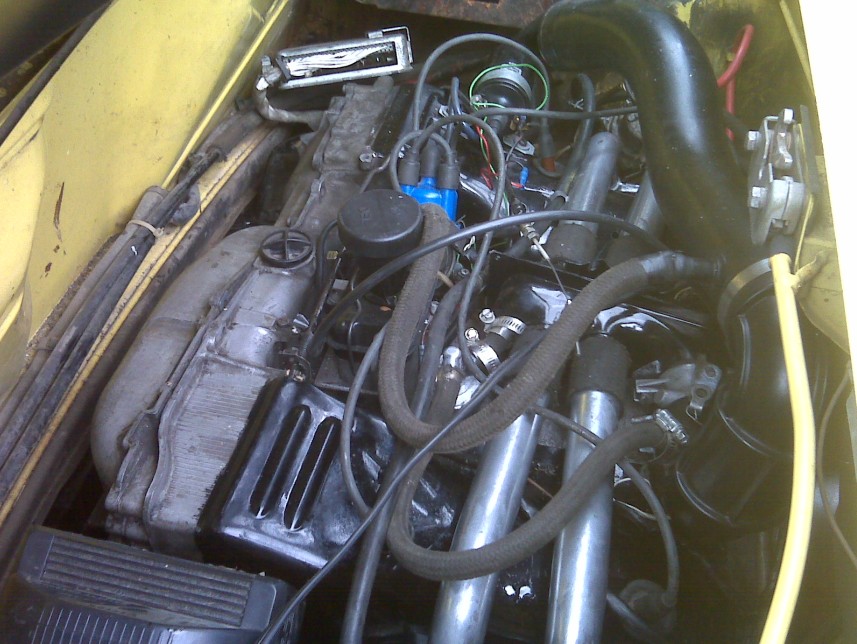

New Motor Pic

It is hard to tell, but the small threaded holes, next to each intake runner are probably screw holes for the sheet metal tin. They thread directing into the head, right? If so, you can leave them as is, or screw a sheet metal screw into them to tie the tin further down.
Also, that is a very interesting intake. Where does it go once it goes down to the right side of the engine?

Cupomeat   It is hard to tell, but the small threaded holes, ...   Sep 28 2009, 01:28 PM
tabs914   It's off a BMW I don't have the cone on th...   Sep 28 2009, 01:36 PM
Cupomeat   Ah, this makes sense now. These are the Air Injec...   Sep 28 2009, 01:56 PM
tabs914   Ah, this makes sense now. These are the Air Inje...   Sep 28 2009, 01:59 PM
