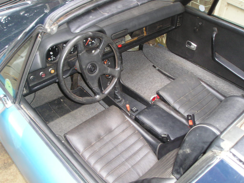

Before I could drive it, I had to do a few things. I fixed the brake and reverse lights. I also installed the seat belts and passenger seat and buttoned up a few other things. Finally the car was ready for a test drive! I took a few shorts drives, stopping to make sure nothing was on fire or anything and I gradually worked my way to longer and longer drives. Needless to say I put over 100 miles on it over 1.5 days without going more like 10 miles from my house. I even managed to take the girlfriend for a nighttime drive.
After hearing how the 914 is underpowered for all these years, I was actually surprised at how much power it DID have. The car accelerated beautifully and handled great. I don't know why no one told me how much fun these cars are! (IMG:style_emoticons/default/driving.gif) I became addicted to 914s when I was 13 and for the past 7 years i had yet to drive one of them until this past weekend. I had a blast driving all the back roads and I am just glad that now I finally have a car to drive. It might not be a looker but it sure is fun!
Two things that I noticed need work is the driver's side rear wheel bearing and the shift linkage needs minor adjustment. The wheel bearing was actually pretty bad so I didn't go above 60 when driving the car. The car is parked this week until I can replace the bearing this weekend. I will also replace the front wheel bearings and seals too. There is still a countless number of things left to do on the car but as least now I can enjoy it some!

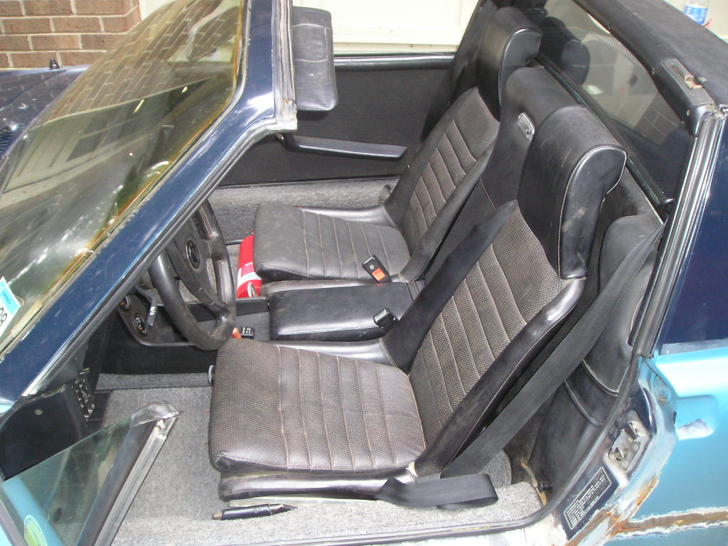

The only pictures I took are of the interior after I got almost everything in. Speaker panels and sill pieces still need to be installed.
-Notice the big fire extinguisher
