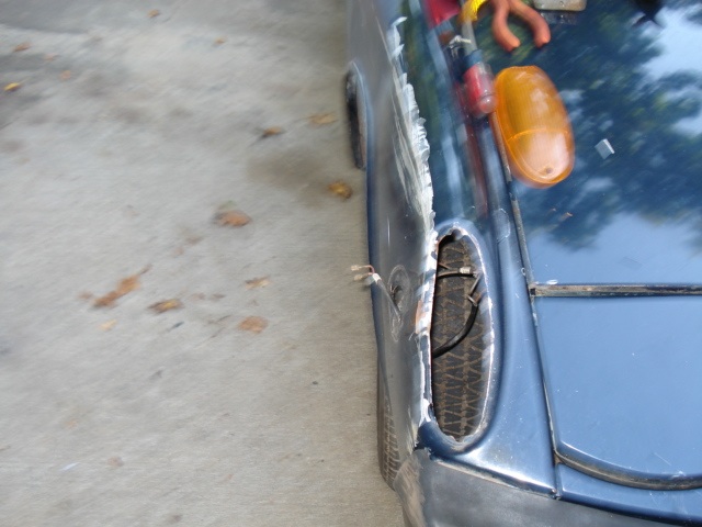

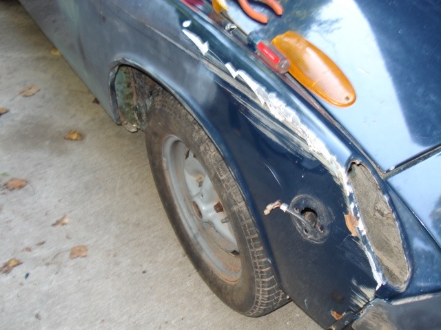

Speaking of not ruining the paint, I forgot to mention how there was a little "accident" over the weekend. After one of my drives, the car was idling a little high. I put the emergency brake on, and ran the car while I adjusted the idle. Once I shut off the car I went into the house. Ten minutes later I came back outside and found that the car had rolled down the driveway and wedged up against a tree. The passenger front fender got pushed in and both lights broke. I forgot to put the car in gear once I shut the car off and the emergency brake wasn't reliable enough. Here are some pictures of the carnage.
I beat it out as much as I could and I replaced the lights so all is good now. I will worry about the finishing touches when I go to do bodywork on the car.
