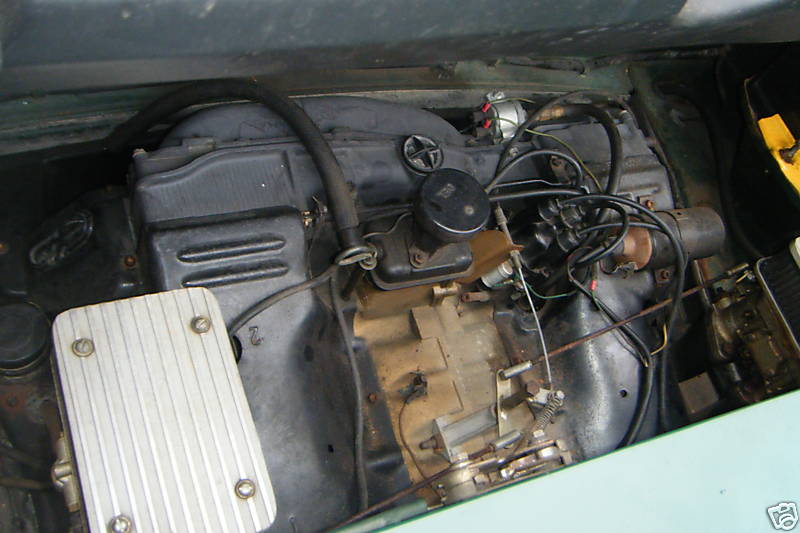

For those who have been following my travails to get this beast running correctly (had a bad rotor), well, it's still running like crap. In fact it stalled out twice today and I wasn't sure Id make it back home from around the block. So, I just decided to dive in and have removed one of the 40s just now. I'm taking photos, counting turns and taking my good old time. I'll let ya'll know what happens.

Wasn't in a big rush because the gaskets for the heads to manifolds won't be here until the beginning of the week. I finished cleaning all the parts today. I did it in about 4-5 stages so as not to mix up parts until I really learn them (carb #2). Cleaned and painted the intake manifold for the one side too. Weekends are for riding (MC) so I'll start putting carb #1 back together on Monday. Believe me...I'll be posting every move. The only trepidation I have is about setting the floats...everything else seems pretty simple. I'll be back (best Arnold imitation).
