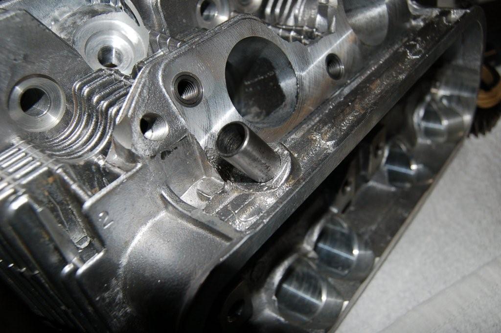

SLITS is right. M10 x 1.25 x 50mm long with a pressed fit. Cap it off.
Tom

tabs914   ***Update*** Ditched the old motor. Oil leaks, rus...   Sep 28 2009, 12:57 PM
tabs914   New Motor Pic   Sep 28 2009, 01:00 PM
Cupomeat   It is hard to tell, but the small threaded holes, ...   Sep 28 2009, 01:28 PM
tabs914   It's off a BMW I don't have the cone on th...   Sep 28 2009, 01:36 PM
Cupomeat   Ah, this makes sense now. These are the Air Injec...   Sep 28 2009, 01:56 PM
tabs914   Ah, this makes sense now. These are the Air Inje...   Sep 28 2009, 01:59 PM
SLITS   Whatever engine you have is a '75-'76. I ...   Sep 28 2009, 02:04 PM
tabs914   Hey if some one knows the length thread and diamet...   Sep 28 2009, 02:10 PM
SLITS   I'll check in in a bit if I can and measure th...   Sep 28 2009, 02:17 PM
SLITS   While possibly not the correct thread, M10 X 1.25...   Sep 28 2009, 02:56 PM
