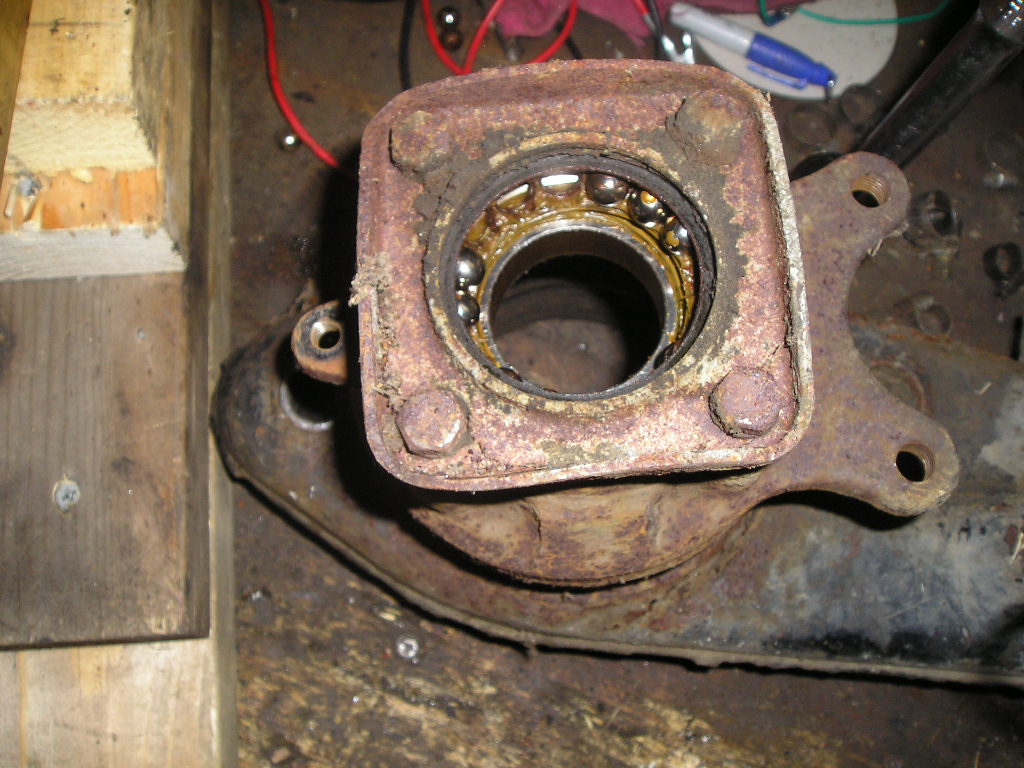

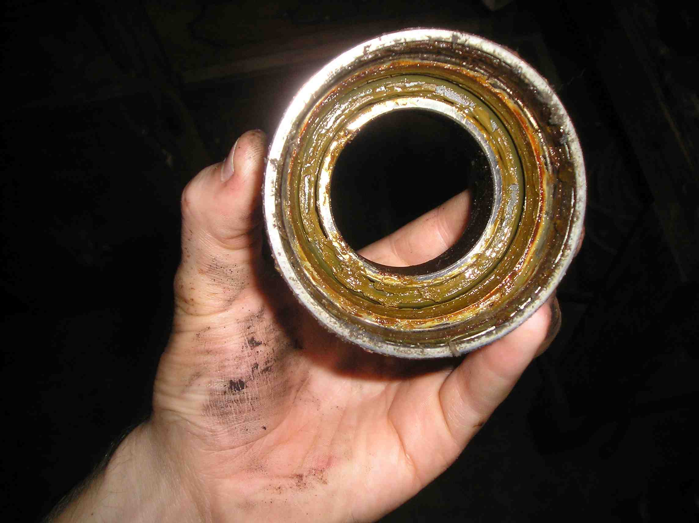

When I removed the hub from the bearing, the inner race came with it. You can see how nasty the inside of that bearing looks. I took a spare hub that I had and put it in the freezer to make installation easier.

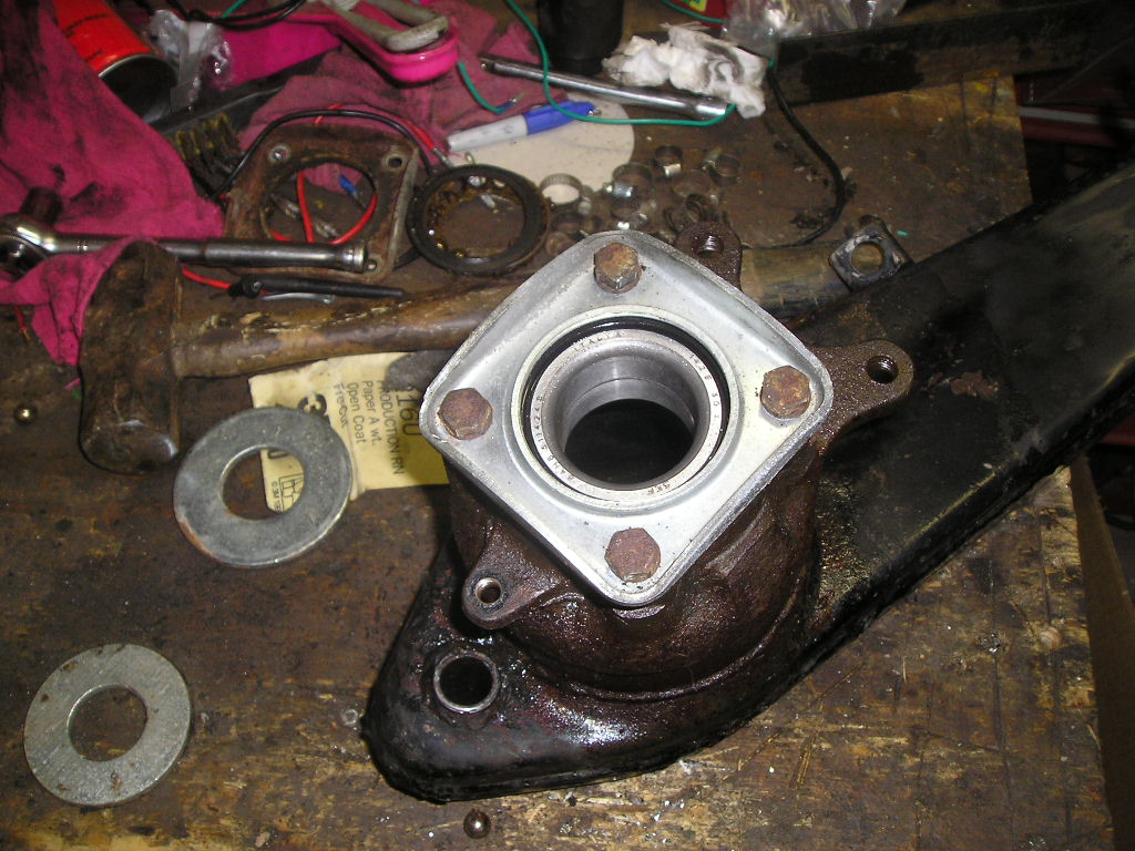

After I pulled the old one out, I cleaned the housing and installed the new frozen bearing. It slide right into place!
