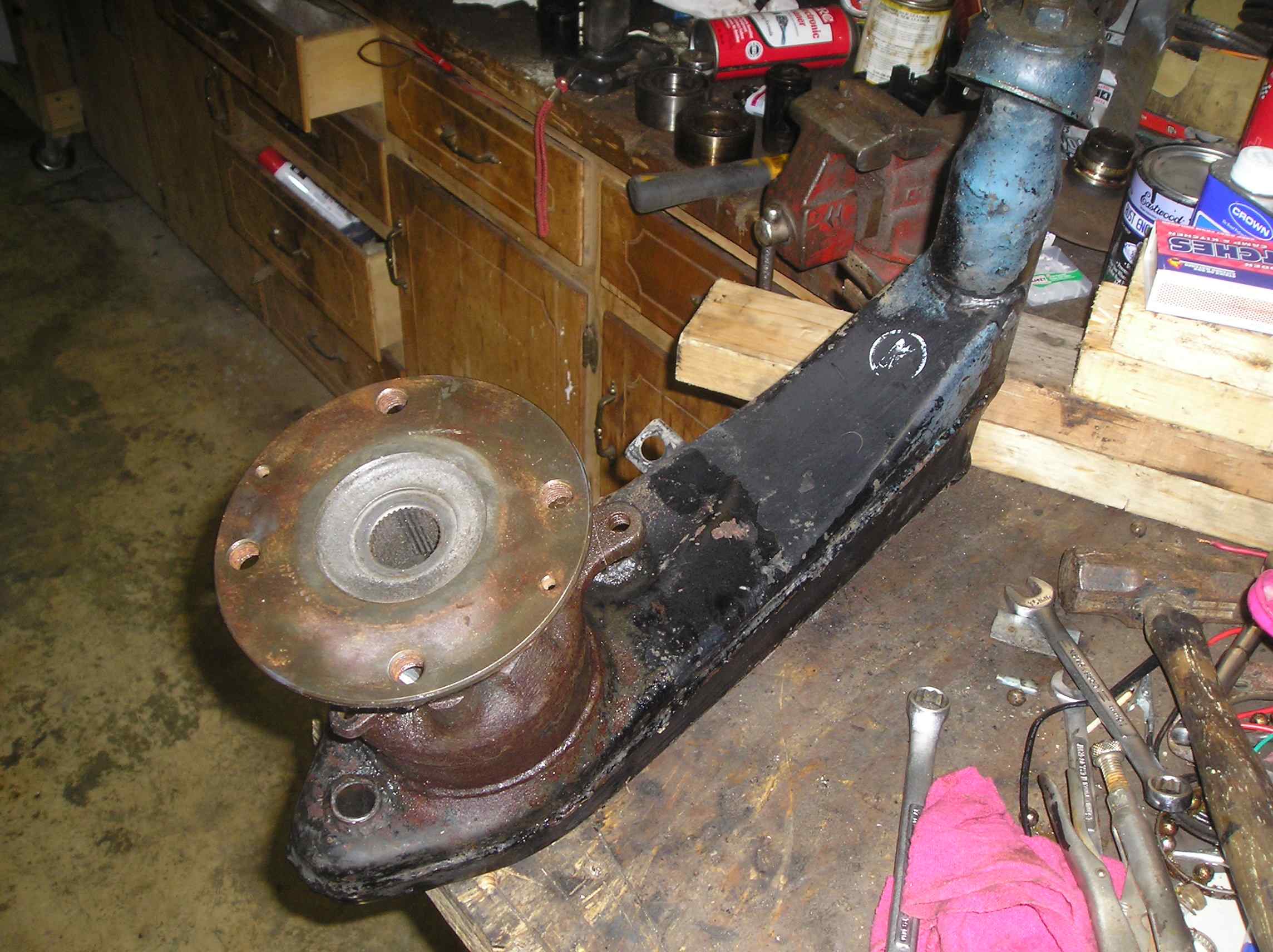

dlee6204   Here are some picture from when I replaced the whe...   Oct 15 2009, 08:48 AM
dlee6204   When I removed the hub from the bearing, the inner...   Oct 15 2009, 08:54 AM
dlee6204   And finally, I installed the hub using some thread...   Oct 15 2009, 09:01 AM
