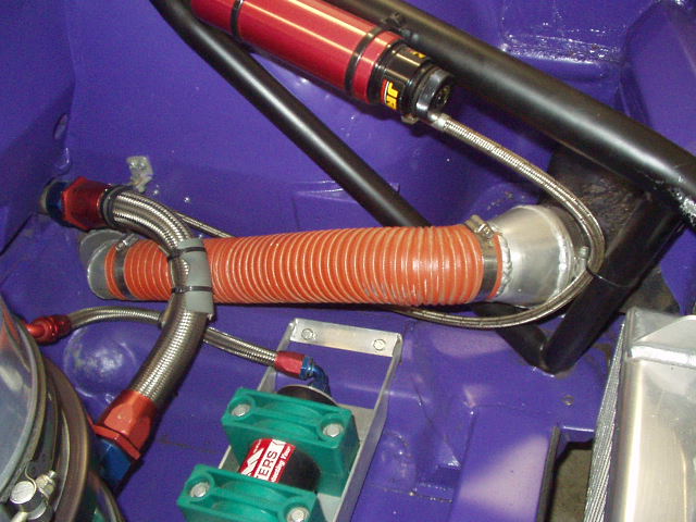

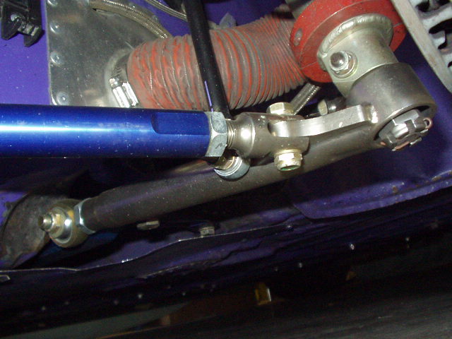

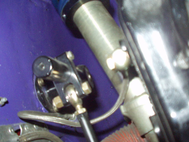

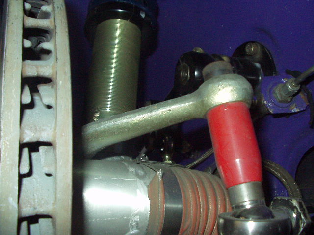

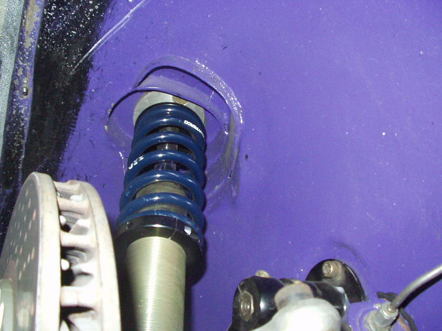

puff adder
post Oct 23 2009, 07:37 PM
Posts: 77
Joined: 9-December 08
From: northern california
Member No.: 9,827
Here's some pics. Photography isn't my forte.

puff adder   My car has JRZ shocks. I'll take some pics a...   Oct 23 2009, 06:39 PM
puff adder   Here's some pics. Photography isn't my fo...   Oct 23 2009, 07:37 PM
Heeltoe914   Here's some pics. Photography isn't my f...   Oct 23 2009, 10:18 PM
puff adder   Thanks very much. The guy who built my car was an ...   Oct 24 2009, 05:58 AM
Heeltoe914   Thanks very much. The guy who built my car was an...   Oct 24 2009, 07:26 PM
