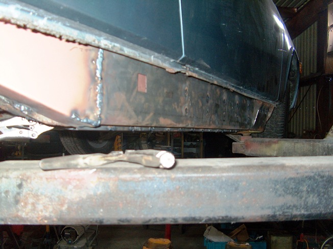

I had the long kits put in as well as new rear floorboards, lower firewall and some other welding. I had a local guy do the welding for me (wanted it done right). I paid $300.00 for the long kit, but that was 2+ years ago.
Here's a pic of the install before grinding, painting, jackposts, etc:
